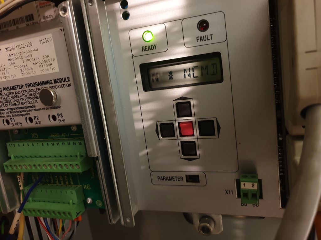

I have found a few pointer - but really not sure what they mean....

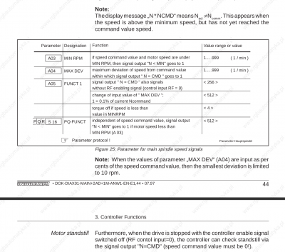

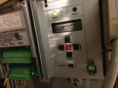

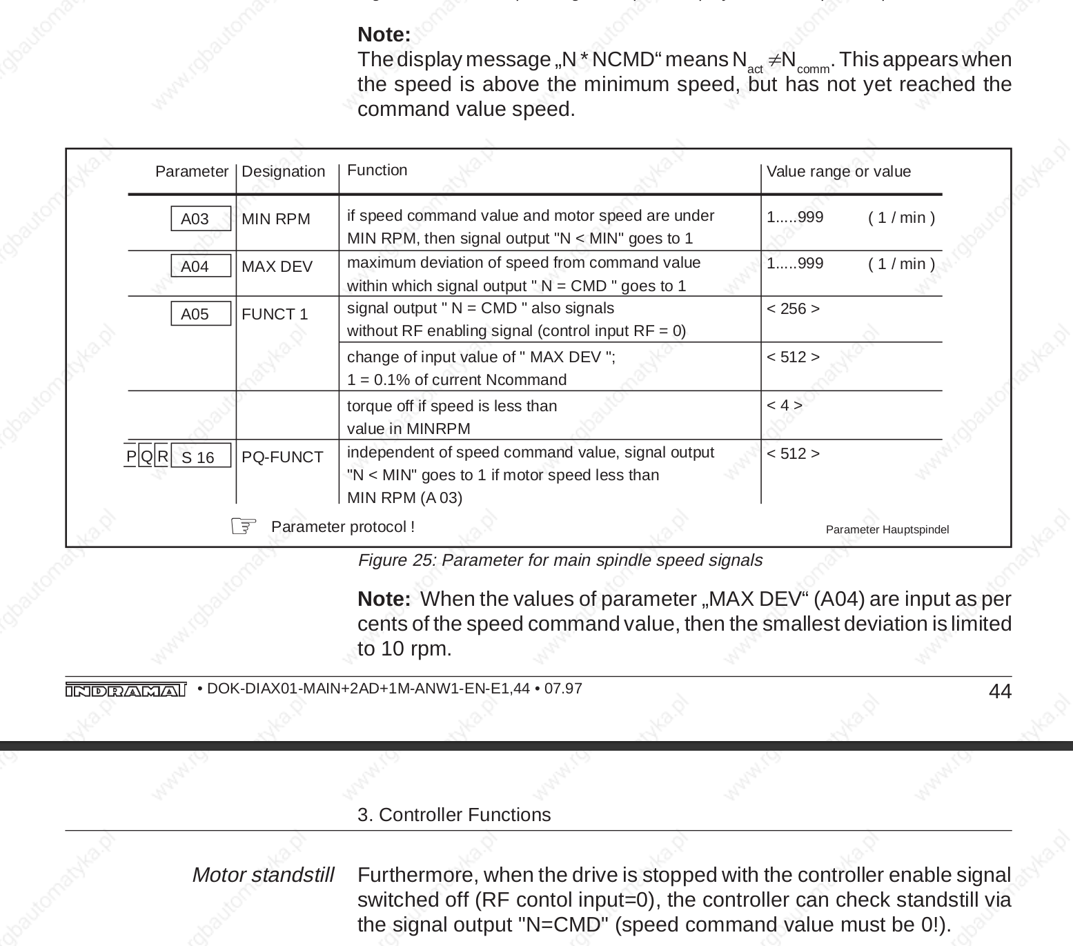

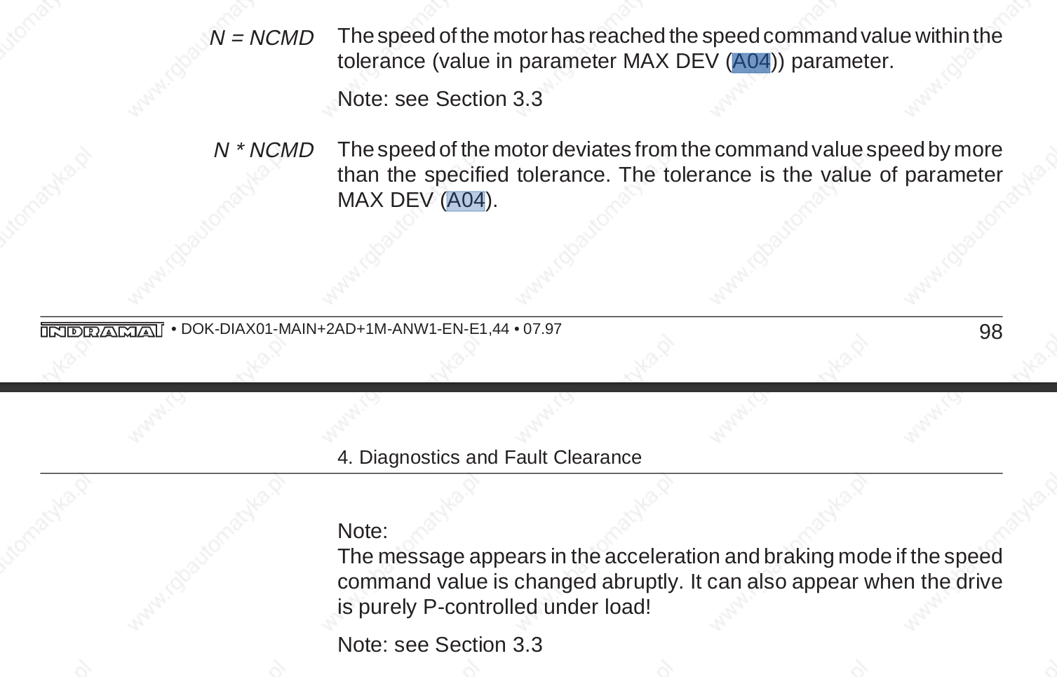

Ok, yea though maybe it should be spinning, so guess I have a bit of work to do around the cables/wiring. Btw, I found a old parameter list for this cnc and to me it seem like this A04 should be set to 50 - if this deviates from that might that causing this error, or should the spindle rotate even when this * NCMD comes up ? , I though it should say "N = CMD" when everything is ok ?.Petroholic pisze: ↑10 lis 2019, 21:08Check cables from spindle, encoder and all fuses...
That message means that the rotation speed of the spindle is different from S command more than A04 parameter...
In other words - if A04=20 and you command S1000 the message won't show if spindle rotates between 980-1020 rpm... When it does the controler puts signal "n=ncmd" meaning that the spindle riched set speed...
By the way - that is not an error (as you see "ready lamp" and no "fault lamp"). That's a message that spindle is not ready yet to mill... But when that shows on screen - spindle should be rotating![]()
Exactly. When reving (speed up) or slowing down to lower rpm...Maws pisze:it will show this message f.ex as long as the spindle is "reving" up tp set speed ?, and then change to N = CMD ?
Alright, have a bit of investigation to do then I guessPetroholic pisze: ↑10 lis 2019, 22:16Exactly. When reving (speed up) or slowing down to lower rpm...Maws pisze:it will show this message f.ex as long as the spindle is "reving" up tp set speed ?, and then change to N = CMD ?
